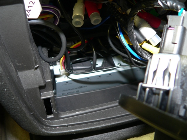

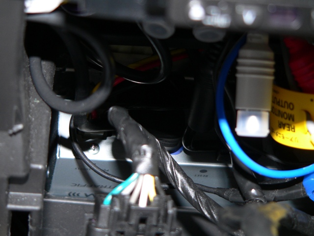

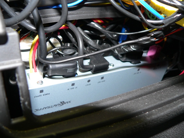

Getting ready for the install, but just curious about this mounting location for the XM receiver. How big is that module? I looked today, and it appeared there would not be enough room for the module and the back of the HVAC controls on the panel.
I have decided to place the camera on top of the trailer hitch in the center of the vehicle. I am in the process of designing a bracket to allow the camera to sit here. Just have to be really careful if hooking up a trailer.
Ok, I got some pictures of the Xm install. As you can hopefully see, it sits way down in there so the top of the XM box is below the HVAC controls.
Attachment 25929
Attachment 25930
Attachment 25931

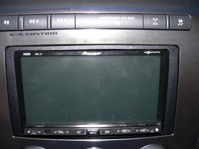

I also finally got the trim ring adjusted right. It always kind of bowed down and left a gap in the middle at the top of the stereo. It was really bothering me so I cut some small pieces of foam to put between the trim ring and the stereo. There is also a clip on the top edge of the stereo opening on the dash piece the needs to be bent slightly.
Here is the after picture
Attachment 25932
