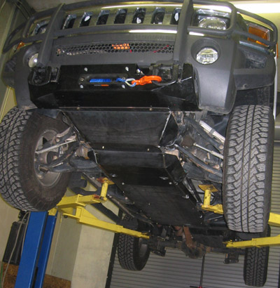

Just got off the phone with Matt from DOI (Nice guy, BTW) and this winch bumper is a reality and sounds just about perfect!
The initial run of 20 should be done and available within about 2 weeks. Pricing is still up in the air.
I expect to have this bad boy on my H3 and SOON!
ThankYouThankYouThankYouThankYou Paragon for finding this!

I've been talking to Matt for a couple of weeks now about his winch design and am having it installed by his shop the first week in June. I honestly think Matt is still in the prototype stage (even though he's completed one already and it appears to be working great). I told him I was willing to be the second guinea pig, and I'm sure there will be more.
He still hasn't completed installation instructions, so I'm not sure this is ready for mass distribution. It does, however, appear to be the best design to date. I will post pics in about a month.

I don't want to speak for Matt, but I will say the price range he was thinking about for the winch bumper during our initial conversations was reasonable. I still don't know whether he's going to meet the price I can get for a Warn XD9000, so I may just pick it up myself and pay him for the bumper and installation.
I'm also going to have him install custom skid plating as I like his designs much better than the "boxed" armor plating from GM which I think has too many hang up points.

Ok, lookin' for some feedback here. I've been stuck in the mud too often lately, and needed to put on a winch. Nobody was getting around to it, so I took the bull by the horns....I designed this winch mount for my H3, just put it on today...and I can have more made. I'm not trying to sell anything here, just looking to get some ideas for improvement. When the design is finalized, this thread will move to the For Sale section.
5/16 steel, high enough to allow for front license plate, no effect on approach angle, fits with or without OEM brush guard. Laser cut, coated with Rubbergard. Sandwiches behind D-Ring mounting blocks, existing bolts have lots of extra length for installation.
Still gotta go get my truck buried in the mud & test it, but I'm pretty sure this is the optimum setup. Gussets should hold the structure just fine, I'll make sure it doesn't bend under a hard pull.
My buddy's got a big machine shop, he made this & can make more, but design may change slightly...a bigger lip in front will make the bend easier, things like that.
The question is, should I have more made if testing proves the strength? Does anybody have any ideas to strengthen it? Am I on the right track?
Pics included, will post more, and taking better ones tomorrow.

Nice work Cris.
I would have been initially concerned with hinge action on your setup, but the reinforced 5/16 material looks pretty rugged. Another thing I like is the easy access to the spool. Is your design a viable option for rigs with a brushguard? Let us know how your tests fare.
I'm partial to the DOI winch bumper myself. :D:D:D
Attachment 23045

Hi Cris -
I like what you've done here. Its a good looking setup. When you're taking better pictures today can you get one looking down from the top?
What are you estimating for a price?
Thanks

Still looking into costs, I'd guess around $325. Pretty inexpensive solution to the winch mount issue.

Okay, some feedback. I like the design overall but a small change would improve asthetics (IMHO) and reduce thigh bashings. Is it possible to "clip" the corners of the mount? See the red circles below:
Ipedog 06-20-2006 05:49 PM
Re: How badly do you want a winch for your H3?
Another view:
Remove the section in red

Cris -
Good suggestion, I'll run it by the fabricator to see if it brings up any other issues.
