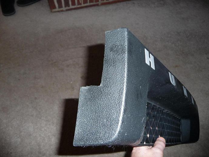

I took a chance on purchasing a '08 grille from Ebay not knowing if it would fit my '05 or not.
IT FITS PERFECTLY! As long as you trade out both the main grille and the center lower black section you don't have to make any modifications at all. It bolts on with 4 easy bolts and snaps right on.
My truck has the front chrome double brush guard and an after market FORGE-TEC full lower grille. It looks like I'm going to have to do a small modification to the '08 grille to put these back on my rig.

2 Attachment(s)
2005 Grille :
2008 Grille:
I'll post another pic after I put the BRUSH GUARD & LOWER GRILLE back on.
I've got to do a small modification to the new 2008 grille before they will fit.

The '08 grille switches out with no problems as long as you switch both the main grille and the lower black plastic grille portion. I had to cut a small section off the sides of the lower piece to allow room for the grille guard to mount but it can't be seen once mounted.
Attached ImagesH2 Grille Switch 005.jpg (67.3 KB, 119 views)H2 Grille Switch 010.jpg (95.6 KB, 108
