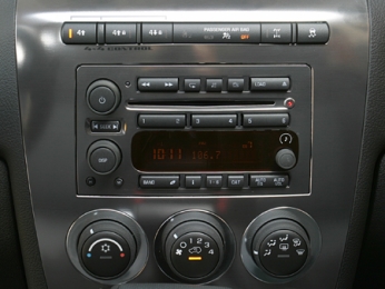

TCCM (also known as the TCSCM) is the Transfer Case Control Module (Transfer Case Shift Control Module), two names the same part.
It is a small control module that is located on the end of the passenger side of the I/P, just under the end cover. Easy to replace, easy to reprogram after replacing. It is used to control the transfer case and the rear locker, if so equipped.
You can still drive the vehicle, but you cannot lock the transfer case; you will still have the unlocked 40F/60R 4x4 system. You just cannot lock it into HI/LO or Lock the rear axle if you have a rear locker.
The STAB SYS/TRACTION FAIL SERVICE will still broadcast across your DIC, unless you press the reset button which turn it off. However, the traction control idiot light will still be on.
Does not affect anything other than the ability for the traction control and stability control to operate, and the little 4x4 indicator lights will be off. I will be driving mine until the new part comes in for replacement.

I'm not sure I can help regarding your electrical, but let's clear up the facts so someone else may be able to jump in...
I'm assuming your dash looks like this:
Attachment 32439
If so, which button(s) are you pressing?

I'm assuming your dash looks like this: YES
Attachment 32439
The right most buttons above the radio: the TCS and the StabiliTrack System buttons. My left most button is lit (4-Wheel High).

The 2nd button from the right is for the rear locking differential, not stabilitrak or TCS. It only engages at a stop in 4-lo. It's normal for the locking diff button to blink and turn off if you're not in 4-lo.

Hooah - roger that. However, the "SERVICE STAB SYS" and "TRACTION FAILED" messages are being displayed regardless of the buttons being pushed. (I have only 253 miles, so I haven't even driven the darn thing enough to even know all the buttons. The only driving of it I have done is basically from the port to the Auto Skills Center on my base.)
