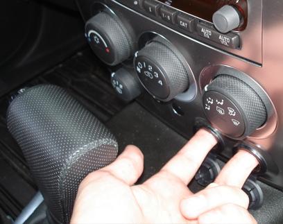

bjc 07-27-2006 03:13 AM
Re: Sirius SIR-GM1 Installation w/ Pics
2 Attachment(s)
Great work. It's just that when I saw this:
Attachment 25839
All I could think of was "Da Shocker"::D
Attachment 25840
