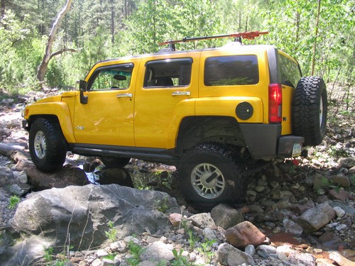

cestwick 08-31-2006 12:06 AM
Re: Hi-Lift Jack mount without roof rack?
1 Attachment(s)
Originally Posted by GotSandH3
Anyone make or fab up some brackes for a Hi Lift jack that can be bolted
to the roof rails or maybe behind the spare tire? I just bought the fuel can mount for the spare tire. Now woundering where I can mount a Hi-Lift jack without spending thousands for a roof rack.
One of or members attached a couple of high lift mounting brackets to his roof cross bars....
Attachment 29151
