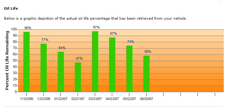

algy 06-22-2007 05:41 PM
Re: Synthetic Oil
1 Attachment(s)
Good read...
I am always baffled at my OnStar oil life report that reads that my oil has 58% remaining when I've exceeded 4K miles. The dealer wants you in at 3K miles and with synthetics OnStar believes that 8K miles you should change your oil. I have been going in every 4.5K miles.
Attachment 41281
