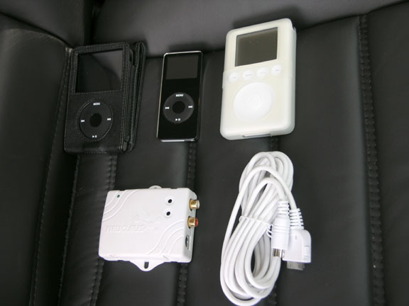

The only parts that you well need are the Neucleus NC-X2i and the NC-GM32T harness. You will also need a few zip ties.

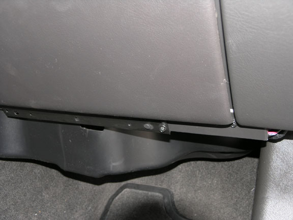

I will now go into the details of this quick install. You will need only one tool for this a 9/32 socket to remove the three screws at the bottom of the glove box. Start out by removing the three screws at the bottom of the glove box. You will find the XM unit right behind the glove box.

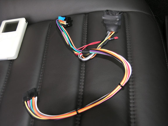

Using the NC-GM32T harness, take the plug that you just removed from the XM unit and plug it into the harness. Now plug the harness into the XM unit.

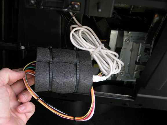

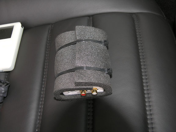

What I did was wrap the Neucleus NC-X2i in a piece of foam like this.
Attachment 36693

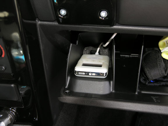

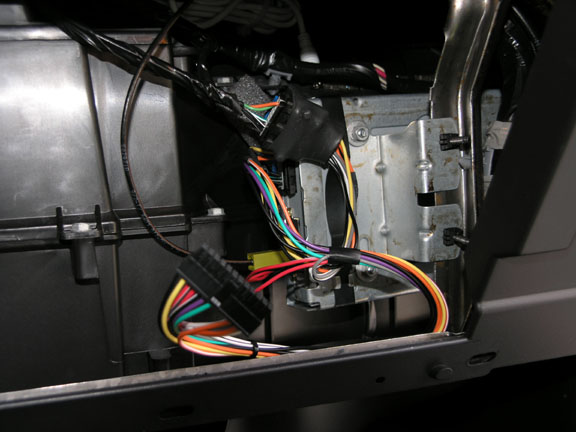

Next plug the Neucleus NC-X2i into the harness. Route the iPod cord to were you want the iPod to be. I mounted my iPod in the left side of the glove box you may want it to be somewhere else. Now plug the iPod cord into the Neucleus NC-X2iIt will look something like this.
Attachment 36697

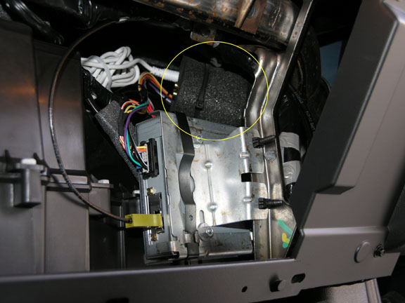

Now tuck the Neucleus NC-X2i and its cords away like this. IMPORTANT turn on your radio but don?t touch the radio controls for a few minutes while the radio learns the Neucleus NC-X2i.
Attachment 36698
While your waiting reinstall the glove box. Plug in your iPod.

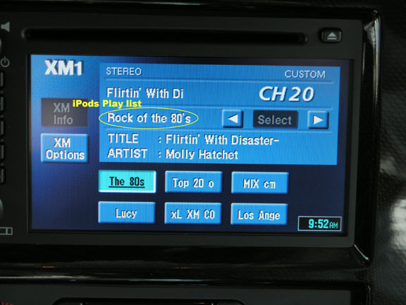

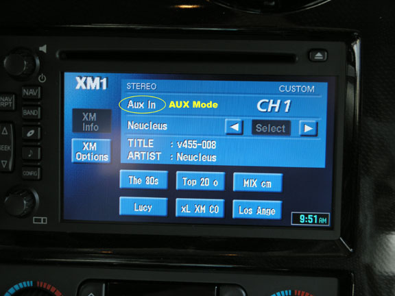

That is all that there is to it. By using the preset button #1 you can now toggle between iPod, Aux in and XM mode.

I used three different iPods a 15gig 3G, 60 gig 5G video and a 4gig Nano. They all worked well I did note that the older 3G was a little slower (a small delay when changing songs using the radios controls) than the two newer iPods. I did talk to American Internationals customer service and they were a very helpful and knew there product. I don?t think that there is a better solution at this time for this application. I will be posting update to this as needed.

Yes you can use the Nav and the iPod at the same time. And if your on your Nav screen and the song changes or you change the song a small banner pops up and shows you the artist, song and track number.
