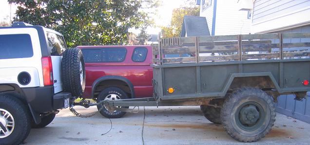

Lex_Ordo 03-15-2007 12:51 PM
New Pics
Here area a few pics of the Recently restored trailer, attached to the H3's Pintle Hook.
BigPoppa1411 03-15-2007 05:06 PM
Re: New Pics
wow that looks great. Im having my trailer hitch installed on Sat. and thanks to your post I am receiving my pintle on Mon or Tues. I just couldnt get over how great that looked, I had to get one too! How does one go about finding a trailer like that though?

Mike E 03-15-2007 08:08 PM
Re: Pintle Hooks
I think thats a Canadian M101 Military trailer. VERY hard to find.

I'm a big pintle hook fan myself -- my trailer is the 3/4 ton version. It needs a paint job, but is otherwise in perfect working condition.
Attachment 37295

DRTYFN 03-16-2007 06:24 AM
Re: Pintle Hooks
Bigpoppa & bjc,
Those are some great trailers!! Any idea about what they weigh?
bjc 03-16-2007 09:04 AM
Re: Pintle Hooks
1,250lbs empty. I've made many trips to the dump where it tipped the scales at 4,000lbs, though. The H3 tows it just fine, but ideally I should have trailer brakes for the types of loads I pull.
Lex's trailer is actually a much better match for the H3. You really can't overload it to the point where it is too dangerous, and it fits and articulates nicely on the trails.
Lex_Ordo 03-16-2007 01:51 PM
Re: Pintle Hooks
Mine is 775 lbs.
I found mine from a surplus dealer in Colorado. He had three left, and now he's sold out.
There are other places, like the site above. Some may need a bit more TLC than others. Mine only needed a few rust repair spots, and new paint.
Then I added all the extra stuff. However, it did come with the tarpaulin.
There is a dealer in Quebec. Name on ebay is Military Tires. Michele Kuntz, I believe is the name.
