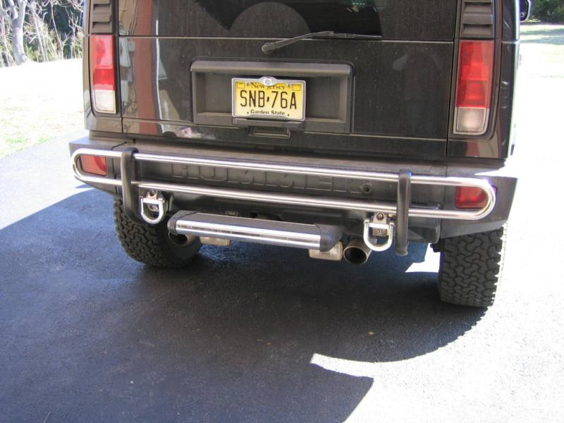

kauaiboy 04-12-2007 10:17 PM
Re: H2 SUV Removing rear tire?
1 Attachment(s)
here is what i did with my 06 H2 SUV coz i also like the look without the rear tire carrier and spare tire in the back...bought a set of SS rear tow hooks from Realwheels...i was going to cover the hole where the word HUMMER is but decided not to...for the rear license plate, i drilled 2 holes on the rear license plate mount (black piece)...no need for the plate lites during the night!!!!

HUM GOOD 04-13-2007 03:04 AM
1 Attachment(s)
Here's what I did when I took off the wheel swing. Rewired the camera plate through the hatch. Left the grommet in the hole. I got billet hooks and a waag bumper gaurd.
I'm actually changing back - I'm getting 37" tires and will need the 5th wheel. I ran without my spare for 2 years. Plug kit was all I carried.
If your interested in the bumper guard and hooks, pm me. They will be going up for sale next week.
Attachment 38210
