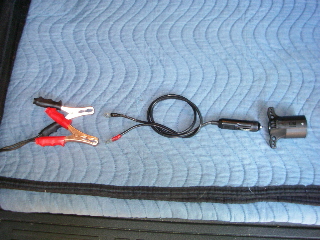

If you have a factory hitch with accesory plug adaptor you are ready to power the compressor right out of the box! Use it from inside the door or outside. You can power it from the battery directly with the clips as intended, but it's real convenient to plug into the 30A fused trailer plug (don't try to use the accesory plug inside the rear door, it won't handle the amp load). You will need a male lighter-plug that has wires that you can clamp the battery power clips to.

Could you post a larger picture of the connection to the trailer plug?

here's the high tech wiring set up (only the factory external trailer plug outlet will handle 30A, don't use the interior accesory power outlet!)
Attachment 38717 Attachment 38718

I never could get the trailer light adapter to work for power so I ran power from the battery back to inside the door following rear wiper power from back to front, works great:jump:

I found this RV adapter at walmart. With a little splicing, you could ditch the alligator clips and plug directly into the trailer harness.
Wisha Haddan H3 07-08-2007 08:33 PM
Re: Easy Air Compressor Install in Rear Door!!
Well I finally got around to it and spliced my compressor to the RV socket plug this morning. I could have used the center pin, but that's a keyed accessory terminal. I went with the 12v + accessory blade for constant power. I took my time and probably spent 30 min on it ... easy as pie.
  1. Check the diagram on the trailer harness cover and verify which blades are which.
  2. Test the blades with a voltmeter. The 12v accessory blade is at about 2 o'clock. The ground is directly opposite at about 8 o'clock.
  3. Separate the terminal adapter from the plug housing, and mark power and ground on the corresponding terminals. RV plugs are directional, so matching the blades is important.
  4. Cut the positive alligator clip and mark it with tape
  5. Cut the negative alligator clip
  6. Thread the plug housing onto the wires
  7. Strip 1/2" off the positive lead, twist the strands and clamp to the adapter's 12v + terminal
  8. Strip 1/2" off the negative lead, twist the strands and clamp to the adapter's ground terminal
  9. **IMPORTANT** Insert the adapter into the plug housing and SECURE WITH SET SCREW. If you don't secure it, it will get stuck in the harness during step 10.
  10. Plug assembled RV plug adapter into trailer harness and test compressor ... congratulations, you're done.
The compressor definitely runs better with a direct battery connection. I might mount it in the engine bay at some point, but this will work for now.
