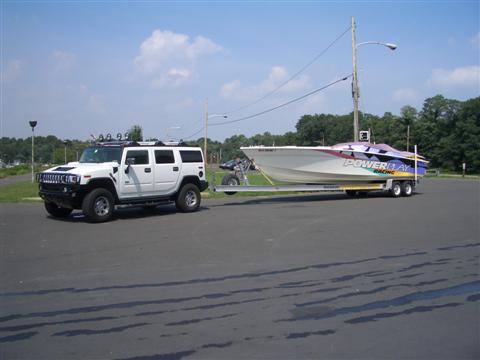

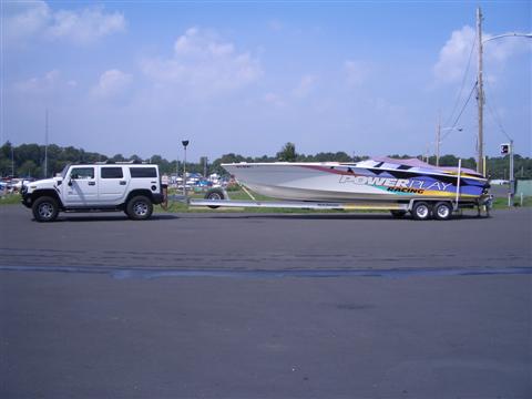

Sundown94 05-06-2007 03:22 AM
Re: Just bought a 26' boat - will my H2 have any prob towing with stock setup
2 Attachment(s)
I posted a similar response to another thread regarding towing capacity. I have towed a 33' powerboat with both gas tanks full on the boat (200 gallons). I estimate the weight to have been about 8,000lbs total, and my truck did just fine. On the highway I got between 8 and 9 MPG, with the A/C on. It would definitely downshift going up any hill, and the steepest hill near my house caused it to downshift to 2nd, but that was the worst of it. :)
P.S. This is my friend's boat and it happens to be for sale right now (if interested, check out www.33powerplay.com).
Attachment 39246
Attachment 39247
