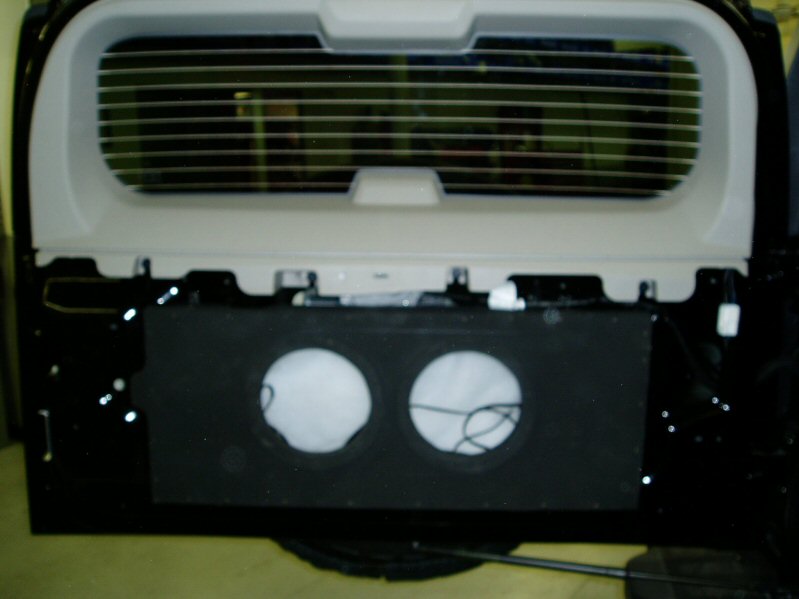

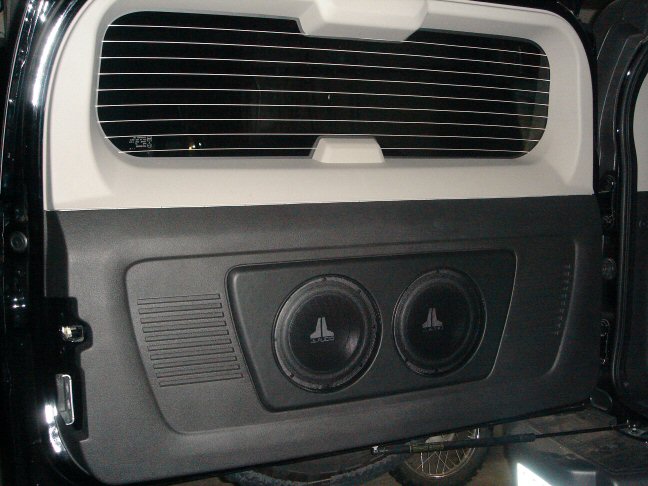

bparker 05-10-2007 09:09 PM
Re: Sub Box
1 Attachment(s)
Attachment 39485
HUMMJAY 05-10-2007 11:15 PM
Re: Sub Box
I've seen that pic in this forum befor,, who makes it??
bparker 05-10-2007 11:24 PM
Re: Sub Box
Its custom. The tire jack was taken out and the entire hollow part of the door was fiberglassed in to make a custom box. I can remove it and go back to factory if/when needed.
I put a JL 500 amp on it and I Love this setup.... it jams...

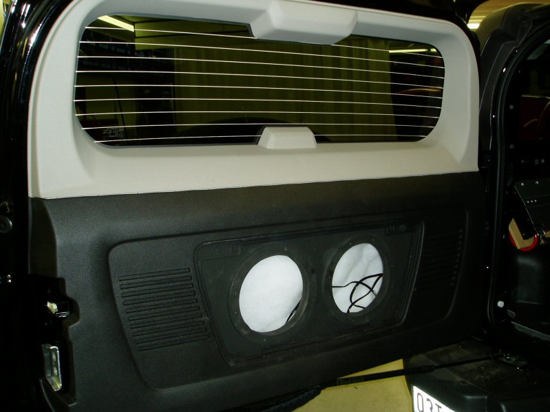

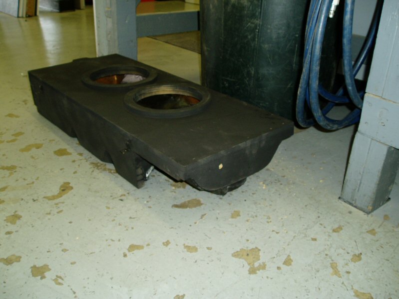

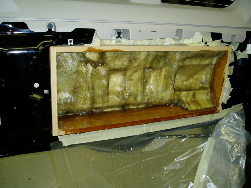

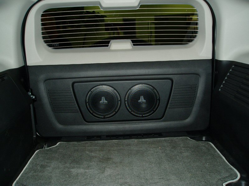

bparker 05-12-2007 03:02 AM
Re: Sub Box
There is a surface ring about 1/2 inch to clear the back of the box. But your right its a tight fit.
bparker 05-12-2007 03:10 AM
Re: Sub Box
5 Attachment(s)
Here are more pics
Attachment 39556
Attachment 39557
Attachment 39558
Attachment 39559
Attachment 39560
