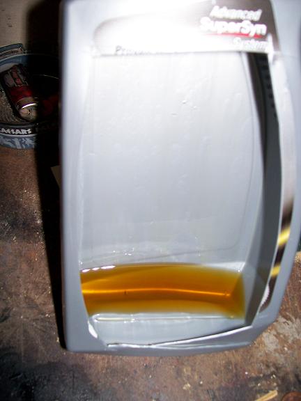

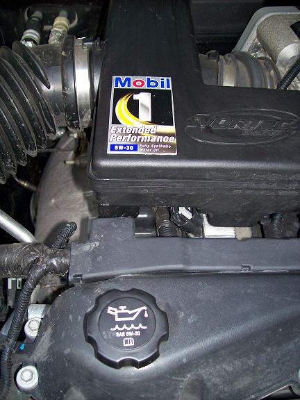

I changed my oil today and I let the container sit in the funnel 30 seconds.
I then cut the face on the container off(to dbl side tape under the hood so regular oil is never added see pic).
Look how much oil was left in there. :eek:
F5 on the ball again :beerchug:
