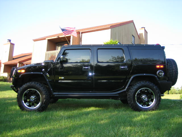

HUM GOOD 06-21-2007 12:10 AM
Re: Torsion adjusting - ?question?
1 Attachment(s)
37s are on - will also be adding extended shocks and steering stabilizerAttachment 41163
IRA51 06-21-2007 10:20 PM
Kool wheels !
HUM GOOD 06-22-2007 02:51 AM
Originally Posted by IRA51
Kool wheels !
Thanks!
