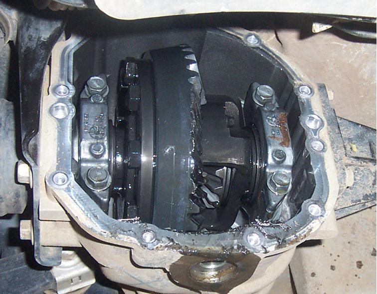

Carrier
Attachment 44222

The pic, is that your 03H3???? Looks pretty nasty....

Originally posted by SR1355: The pic, is that your 03H3???? Looks pretty nasty....

No Paul, I think Bebe originally posted that pic. If it wasn't hers it was in a thread she started. ;) Thank God that isn't mine, damn thing does look nasty.
