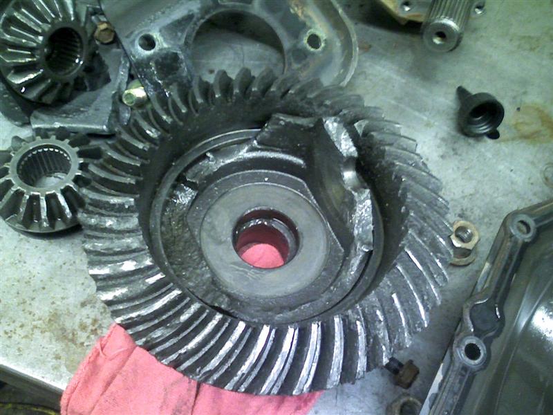

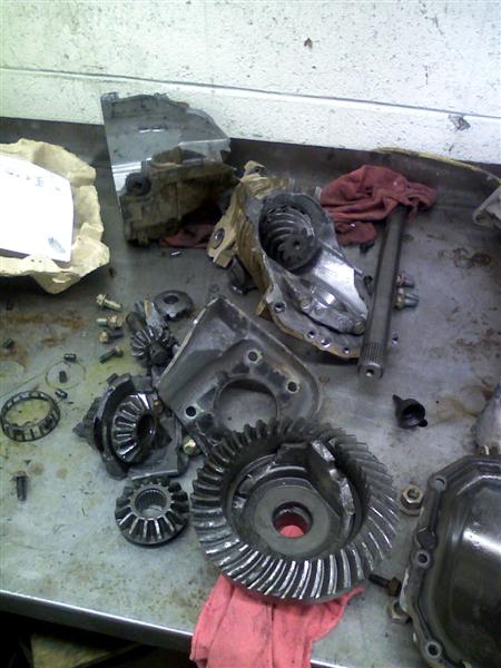

3 Attachment(s)
Originally Posted by Dave92270
now, what happens there in detail - the gears teeth are stripped/broken, or the gears dislodge, or/and the housing cracks too?
Sometimes all of the above. :mad: Here's what's left of my last one.
Attachment 45176
Attachment 45177
Attachment 45178
In this case, the gears stipped first, then the case cracked. I had to get dragged a couple miles off the trail (Fordyce) and eventually the carrier blew apart. When the tech at the dealership took it out it basically fell apart into what you see in the first pic.
