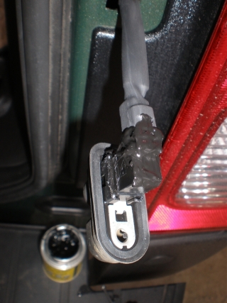

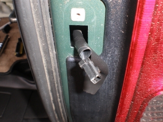

Pulled the rear cargo door jamb switch and pulled off boot to shake out all the water. Had to let it dry completley. Be sure to tape off the lead/wire so it will not fall into the hole and then you will have to fish it out.
Attachment 50534
Used heat shrink tubing around the conections and then used liquid electrical tape around switch to seal it from water.

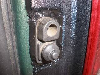

I then installed the rubber boot back onto the switch and put the switch back on the rear cargo door. When the switch is back to it's original place, seal the outside of the rubber boot with a flexible silicone gasket seal.
