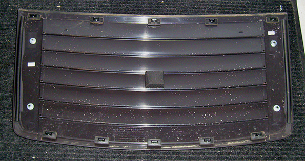

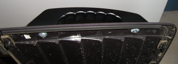

Ed G. 03-07-2009 02:24 PM
Re: H3 Hood Handles
2 Attachment(s)
These should help,
Attachment 50658
Attachment 50659
OZH3 03-11-2009 05:17 AM
Re: H3 Hood Handles
Thanks guys for all the help and pictures it has answered my questions. It really puzzled me about the headless bolts. Still not sure why they sell them like that but I guess I will just fit nuts on the ends.
