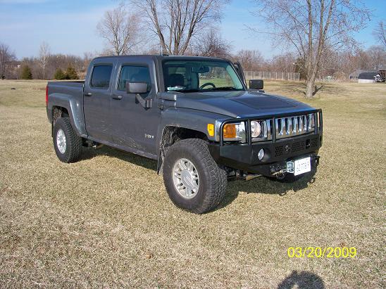

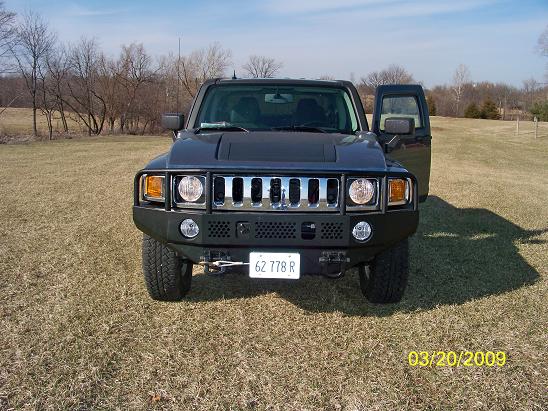

I received all my parts and got the bumper installed. I haven't cut the rest of the plastic or bent the skid plate yet so the pics may look a little sloppy. The installation was pretty basic once I received the parts and instructions.
Attachment 50698
Attachment 50699

Looks good! Hope you got one of the smoking deals on Ebay.
terry_ohio 03-21-2009 01:04 AM
Re: Boulder Bumper/Winch on H3T
that is definately a "get out of my way intimidation" piece...i likey!
Metallic Red 03-23-2009 02:21 AM
That thing looks awesome it almost looks military. :perfect10s:

dochummer 03-25-2009 05:45 AM
How did you mount the license plate?
Nips 03-25-2009 01:26 PM
They sell a bracket that attaches to the pins for your rollers. It hinges up out of the way when you use the winch. Pretty slick setup.

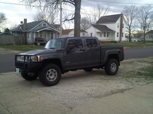

Nips 03-27-2009 03:00 AM
1 Attachment(s)
I cranked my torsion bars about 4 turns on the right and 4.5 on the left. It still sits about an inch or so lower than the back. It raised the front about 2 1/4 so far. The extra weight of the winch drops it a bit. I have an alignment scheduled for Monday so I still have a few days to play with it. I searched old post but never found a definitive answer on the "max" turns that are safe. Any thoughts? I may leave it as it is as it looks a lot better than the previous pics before adjusting
