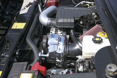

Contemplating a procharger Attachment 51935to boost the HP up into the 800 range. I think I will destroy my 4L65e soon, so I am looking at an 80e. We will see how she runs in a few weeks when the intake and fuel rails come in. FAST/Comp Cams is still manufacturing the first fuel rails and hardware to put the LSXRT manifold on a chevy/hummer truck. I may be the first customer in the world to receive the new intake and hardware and get it on a rig and running. My H2 engine is in the truck, only waiting on the intake components to fire up. Will hand build the CAI from 90mm tubing and hoses I bought online.
They are telling me 30 hp increase with my setup. I wont know for sure, because I am not going to dyno it with and without the LSXRT. :beerchug:
