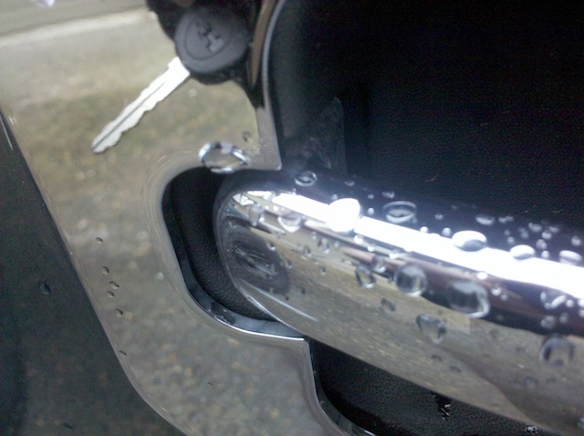

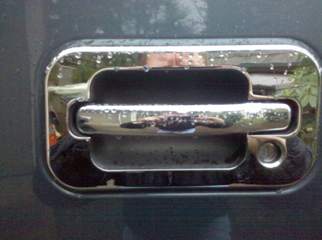

I was told at the Hummer dealer that to get these off I would need to unbolt from behind the door panel.
However, it looks like these are Chrome overlays that are applied with adhesive.
The reason they need to be removed is because I am powder coating all the chrome to black.
It seems that even if I did remove the entire piece that the black plastic would come with the chrome pieces, and that would make it impossible to bake the powder coat on.
Any suggestions? It seems I should be able to somehow remove these overlays... or no??

They look to be the 3m tape on cover type and with some light heat from a hair dry and some goo gone you should be able to remove them. the ones that you have to remove the door pannels and all that are the full buckets you would not be able to see the black plastic at all it would be chrome.

Without looking at them I don't think anyone will be able to give you an accurate answer. Maybe you could try using a heat gun(or hair dryer) to test your adhesive theory. Most likely they're going to be bolted.

Stuck on with 3M tape maybe ? That is how it looks in the pics. :confused:
Might try a hair dryer to loosen the tape and get a piece of fishing line behind them and work the line behind it to remove. This was how I removed the H2 emblems from the front doors of my truck. WD40 is good at removing the excess tape.

THanks all. I just got back from the powder coater and they appear to be stick ons. Hoping I can get them off. I've got a heat gun so ill give it a whirl.

Looks like you've already confirmed this, but the door pull is factory standard chrome, and the rectangular cover is the overlay...

I'd probably go all texture or all not...with black, a little texture makes things look interesting and different. As for the door handle covers, you'll probably have permanent adhesive damage on the plastic door bucket when you take those off. But you may be lucky and have it come off completely - the problem is the bucket is plastic.

As far as the door handle covers they came right off with no damage to the oem buckets. The worst part was having to take the entire bumper off just to get the damn tow hooks off.
