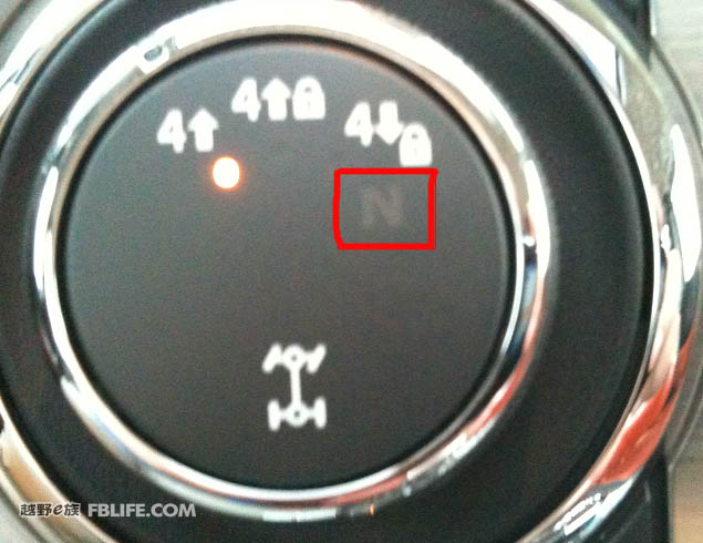

08 Hummer H2 trailer help with how to light up the red N, specific how to do, ask for
1 Attachment(s)
08 Hummer H2 trailer help with how to light up the red N, specific how to do, ask for help. Thanks
Attachment 52976
Road Warrior H2 09-21-2010 07:46 AM
Re: 08 Hummer H2 trailer help with how to light up the red N, specific how to do, ask for
[/color]This is how the Manual describes shifting to Neutral and the second page shows shifting back out of Nuetral.
Hope that helps you.
You are a long way from me in Alberta, Canada. ;)
Shifting into NEUTRAL as follows
To shift the transfer case to NEUTRAL do the following:
1. Make sure the vehicle is parked so that it will not roll.
2. Set the parking brake and apply the regular brake
pedal. See Parking Brake on page 2-40
3. Start the vehicle or turn the ignition to ON/RUN.
4. Put the transmission in NEUTRAL (N).
5. Shift the transfer case to Two-Wheel Drive High.
6. Turn the transfer case dial clockwise to NEUTRAL
position. The transfer case will not shift to NEUTRAL
unless this position is held for 10 seconds.
The NEUTRAL light will come on and then the dial
can be slowly released. The dial will be in the
Four-Wheel Low Lock position but the transfer case
will be in NEUTRAL with the NEUTRAL light on.
7. If the engine is running, make sure that the transfer
case is in NEUTRAL (N) by shifting the transmission
to REVERSE (R) for one second, then shift the
transmission to DRIVE (D) for one second.
8. Turn the ignition to ACC/ACCESSORY, which will
turn the engine off.
9. Place the transmission shift lever in PARK (P).
10. Release the parking brake prior to moving
the vehicle.
11. Turn the ignition to LOCK/OFF.
Shifting Out of NEUTRAL as follows
To shift out of NEUTRAL do the following:
1. Set the parking brake and apply the regular brake
pedal.
2. Shift the transmission to NEUTRAL (N) and turn
the ignition to RUN with the engine off.
3. Turn the transfer case dial to Four-Wheel High,
Four-Wheel High Lock or Four-Wheel Low Lock.
After the transfer case has shifted out of NEUTRAL
the NEUTRAL light will go out.
4. Release the parking brake prior to moving the
vehicle.
Notice: Shifting the transmission into gear before
the requested mode indicator light has stopped
flashing could damage the transfer case. To help
avoid damaging your vehicle, always wait for the
mode indicator lights to stop flashing before shifting
the transmission into gear.
5. Start the engine and shift the transmission to the
desired position.
