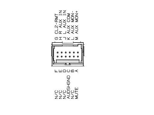

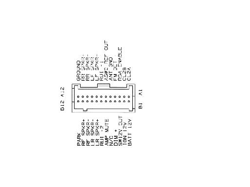

Think these are the pin-outs for both
BTW on the small connector block - PIN A puts the radio into "Phone" and activates a mono audio input across pins L and M
