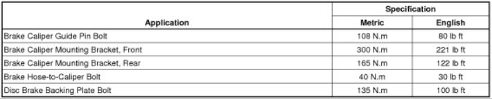

Okay so I get new rotors and pads, started to changed them out and I can not get the bolts lose to remove the Brake calipers on the front and on the back looks like you need a hex style key to remove two of the bolts and same thing with the 18mm bolts on the back. I dont have a air wrench and not enough A** to wrench them off with my hands. any tips

i had to use a 1/2" breaker bar with a 2' pipe extension totaling about 3' of leverage. it was crazy how tight those 2 bolts are.
220 ft/lbs for the calipermounting bolts.

1 Attachment(s)
These are the torque specs plus some of the bolts will have loctite on them
Attachment 53457
