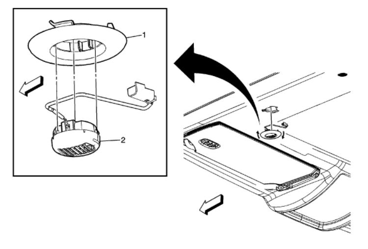

Thats not a mic its the inside air temp sensor or also called the aspirator. there is a small fan inside that draws inside air inward to monitor temp for the auto hvac controls. If its making noise you either live with it or replace it.
twr 09-20-2011 01:51 AM
Re: buzzing noise in the small overhead speaker
1 Attachment(s)
Hi this is the onstar mic. in the pic i am not sure if this is what is buzzing or the
inside air temp sensor that is back about a ft. in the drivers side headliner as HUMTECH said
Attachment 53463

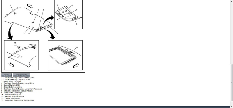

twr 09-20-2011 02:19 AM
1 Attachment(s)
Hi 12 is the onstar mic and 13 inside air temp sensor hope these pic help.
Attachment 53465
SkiUtah 09-25-2011 09:42 AM
Its the air temp sensor I will pull it out and take a look at it. Thanks for the replies.
