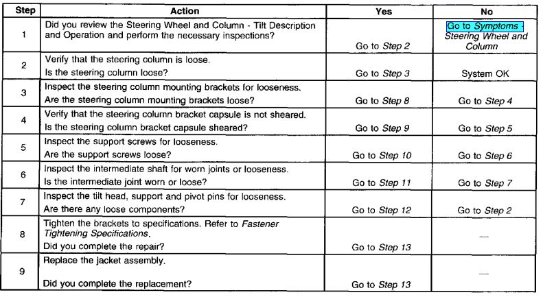

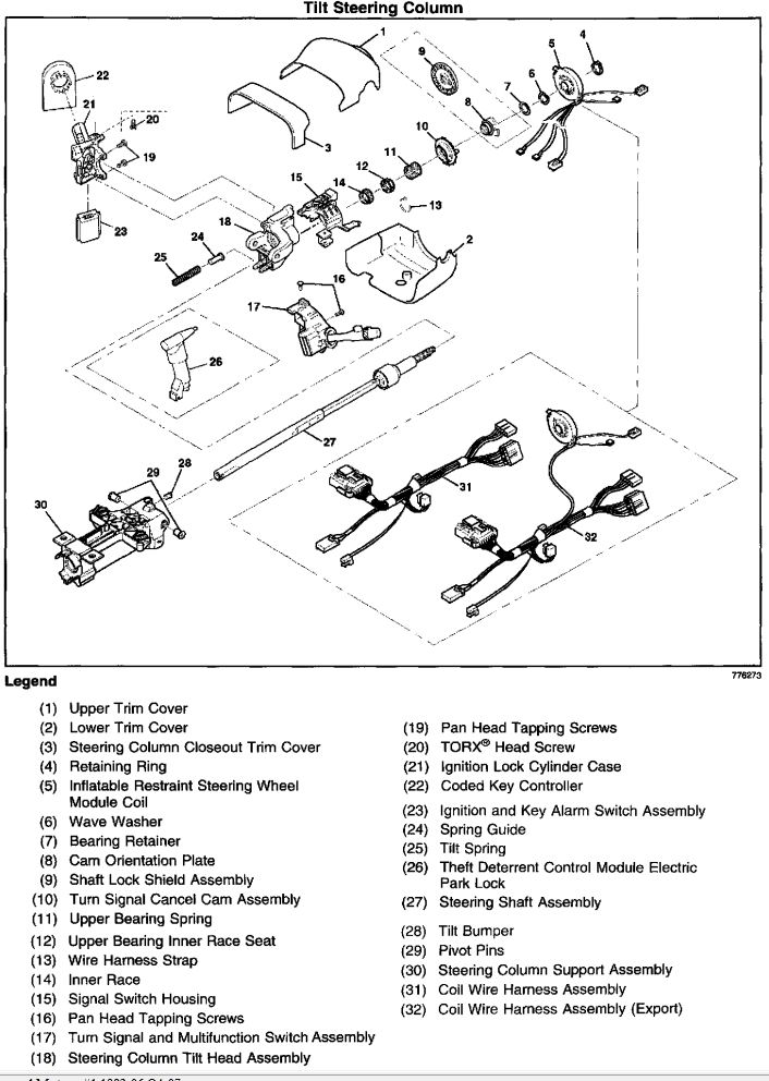

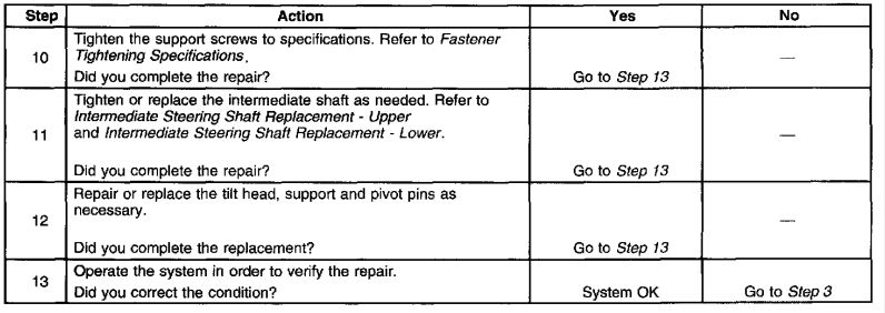

can't tell from the video. Does it feel like the wheel is loose on the shaft? or does it appear tight on the shaft and the entire shaft is wobbling in the column/tilt assembly?
Attachment 53789
Attachment 53790
Attachment 53791
