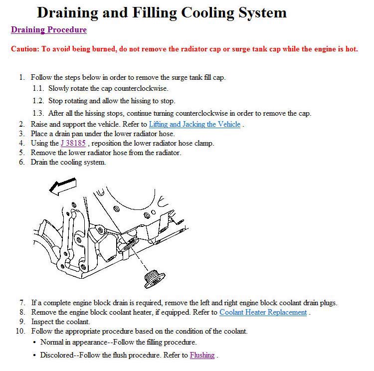

These Plugs ?

Originally Posted by Easy Ed
These Plugs ?
No those are the engine block drain plugs. In your manual under the fill procedure it should mention the bleeder plugs no?
Easy Ed 06-23-2012 12:30 AM
Re: Where are the cooling system bleeder plugs?
First pic and part of second one is about the drain and fill of the coolant system, no mention of drain plugs except for the engine block ones.
Edit: Number 6 is the only mention of a "drain cock".

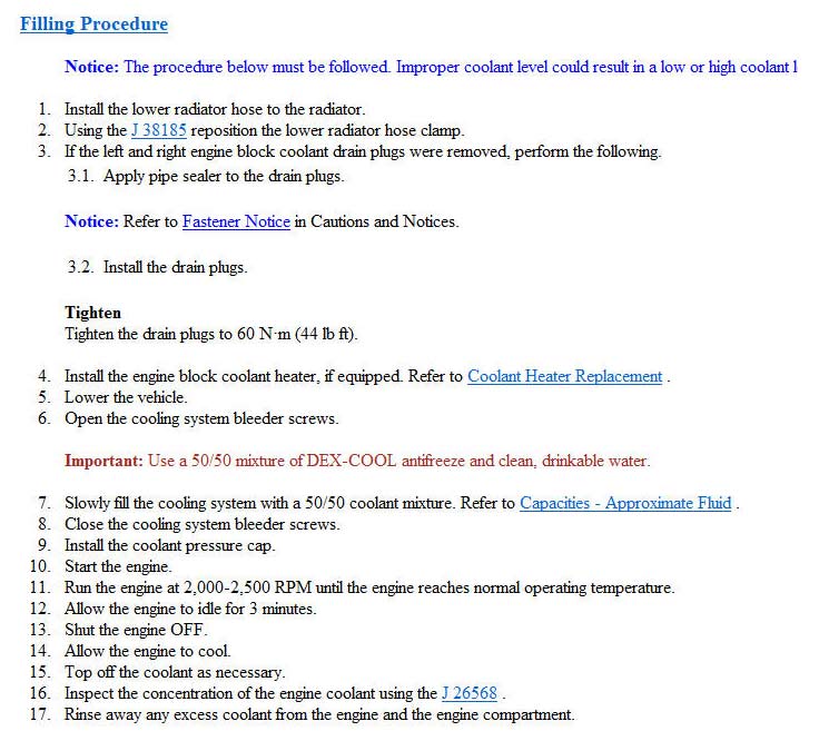

pdxrealtor 06-23-2012 01:02 AM
2 Attachment(s)
Check it out...
Found here.... http://www.*******club.com/forum/vie...hp?f=3&t=11337
Attachment 53872
Attachment 53871

I think my 3 and 6 in the Draining and Filling Cooling System pic are the same as your 6 and 8 in the Filling Procedure pic of yours, just a different name for the same item ???
But re-reading it I am not sure why it would want the drain (bleeder screws) opened before putting in the coolant ???

Ya sure those instructions are not for a H1 ? These instructions show "air bleeder screws".
Just a thought while I am trying to help and google for some info :o
Edit, nope they (yours) are for a H2, now I am more confused................
