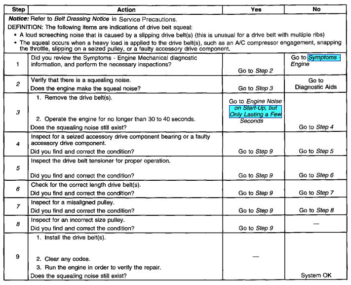

1 Attachment(s)
where are you where its going to take 2 weeks??
if your pulley is ****, your most likely going to need a new belt from it slipping anyway.
There is a spring tool to test the tension on the belt.
Hose the pulleys and belt (both sides) down w/ brake cleaner and see what it does. That will actually clean dirt/grease off.
Attachment 53923

But what I'm going to do, is get my belt out today and find one that matches it, I'd like to go OEM, but it's probably not going to be possible to get it locally.
Thanks for the photo of the repair manual, I actually took a look at it yesterday after making the thread, and it explains very clearly on what should be done to diagnose the problem. I'll try to solve this today if possible...
