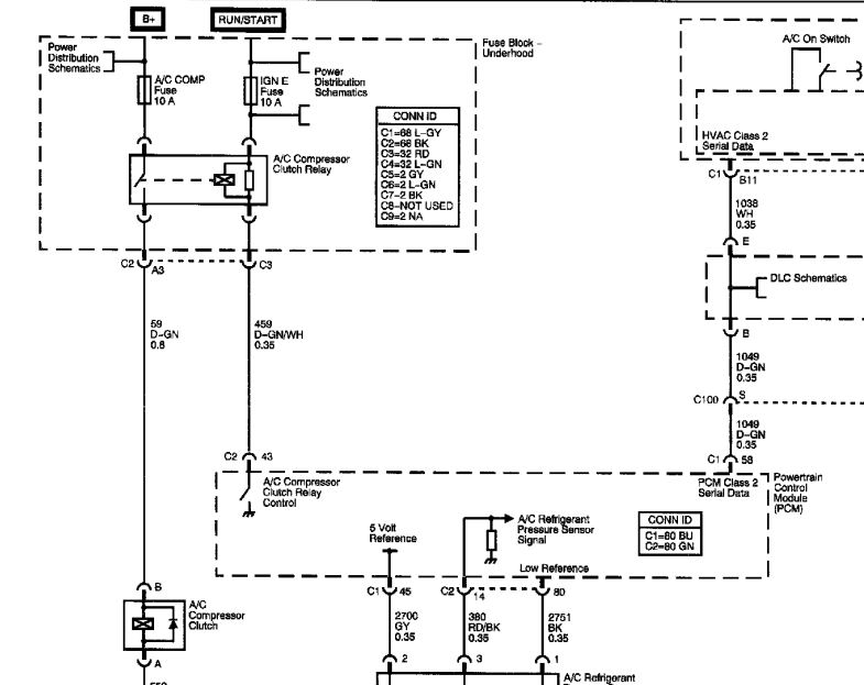

[__--MUD--__] 09-06-2012 01:52 AM
Re: E-fans, Diablo, And Nelson
1 Attachment(s)
Attachment 54039
Easy to verify- Jab a 12V test light at the compressor end, turn the ac on/off. Light should follow your switching. Hit pin 43, should do the same.
The line on the compressor side should be solid dark green. On the PCM side it should be dark green & white.
