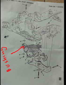

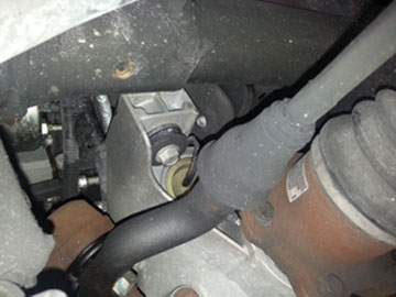

As I post early My H2 was having a bumping/knocking noise while driving around 50 mpg
I found the the differential rubber mount tear as shows in picture ..
Dealer ask my $110 for the new bushing and $720 for labor .. They said in order to replace the mount the whole differential needs to be removed ...
Please if someone knows if this is right or if any way to do it as a DIY job... I see $830 very pricey to replace a rubber bushing
BTW the guy in the dealer told me to rotate the tires to avoid the noise ,,, he said rubber may be worn but what is causing the noise is the vibration from a tire with a problem , makes sense to rotate the tires and see what happen ... :confused: :confused:
Attachment 54328
Attachment 54329
HummerJim 07-12-2013 10:27 PM
Re: Broken Mount , Dealer charge $900 ... Help
That's a three hour job tops. Find a good Indy and RUN from that dealership.
H2Miami 07-12-2013 11:36 PM
Hi Hummerjim ... they quote me 6HR @ 120 plus the part plus the tax
Do you know if not removing the diff is an option
Thank you
H2Miami 07-21-2013 07:56 AM
Just updating ... After trying in different mechanic shops I decide to re-balance and rotate the tires to give a shot and guess what ..
The bumping/knocking noise is gone
OG I just save $900 Life is good :jump:
