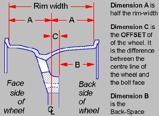

First off...a -12mm offset on a 9" rim would be about a 3" backspace. Here's a good offset/backspace calculator: http://www.customwheeloffset.com/tir...et-calculators
The 'offset' tells you how far off the bolt face is from the rim's center line. Negative offset puts more of the rim/rubber out of the fender wells and a positive offset puts more rim/rubber in toward the suspension.

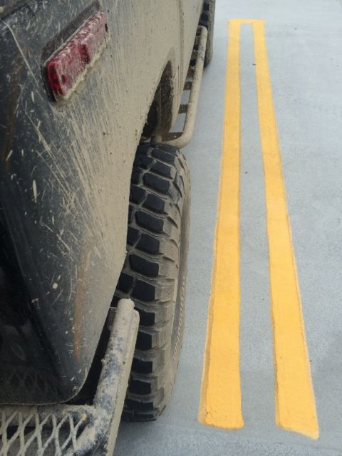

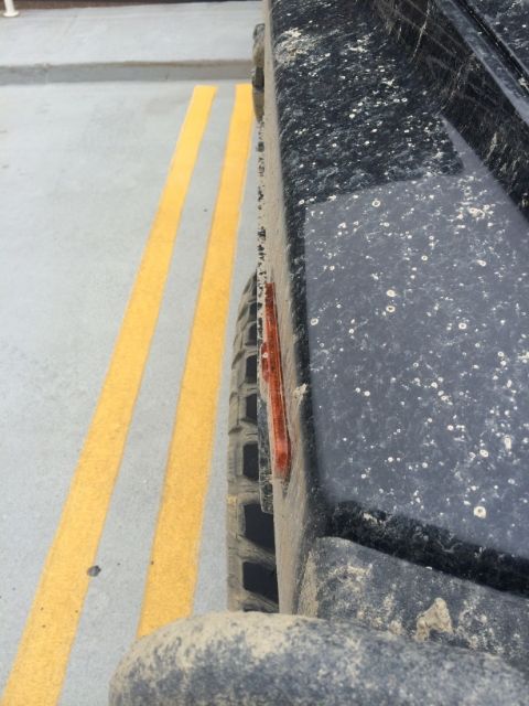

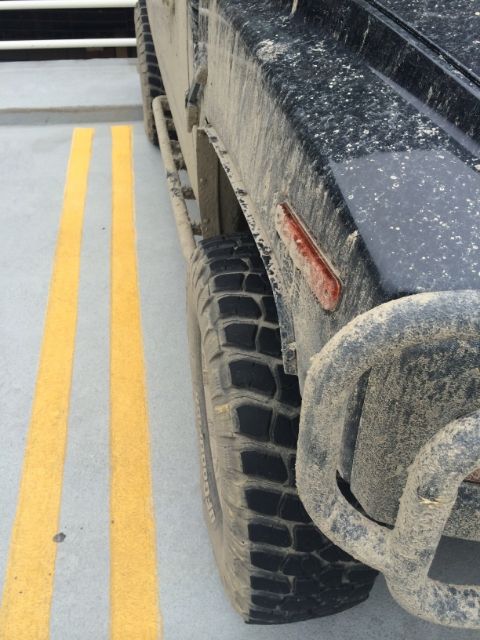

My Rockstars are 18x9 with a 0mm offset (so a 4.5" backspace). I'm running 37x18x12.5 BFG MTs with no flares and have about 2" of rubber poking out. When I still had the stock flares they poked out about an inch. I think you'll either need a wider tire or a rim with more of a negative offset (shallow backspacing) to get the rubber to reach the edge of an EG-style flare (larger than stock).

I still don't get it...according to this (and just about every other image I find) a 0mm offset means that your backspacing is exactly 1/2 of the wheel width.
So...why does every offset/backspace calculator I find say that a 9" wide rim with a 4.5" backspacing is a -12mm offset?
LoJac963 07-25-2014 04:01 PM
Re: What backspace are you running on your 2's wheels, pics??
Exactly my point, I get backspacing-its a no brainer. Bring offset into that equation and it makes absolutely no sense.
You are correct though, a 0mm offset would put the mounting face at exactly the middle of the wheel. So a 9" wheel would indeed be a 4.5" backspace.
