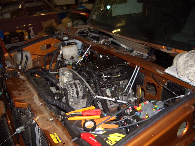

i am currently converting my second H2 to right hand drive, here is Australia, it is a brand new (yes it has taken this long to get it here) 2006 fusion orange limited edition. i am nearly finished the RHD conversion and hope to have it on the road next month.
I have fitted Brembo brakes, (plan on supercharging it later) but have found that when at idle the hyrobooster doesn't have the line pressure to turn the steering wheel with foot on the brake, i have modified the power steering pump to up the line pressure to 1440 psi and it has alleviated the problem significantly, but i am finding that i need to stall the car a bit by use of accelerator to turn the wheel when static.
Does anyone know if there is a booster to accompany the brembo's or a solution to this problem. the factory booster and pump etc are used and line pressure is to spec as i ran pressure guages on the lines to diagnose.
Brenton
PS here are some pics of a new h2 cut up
