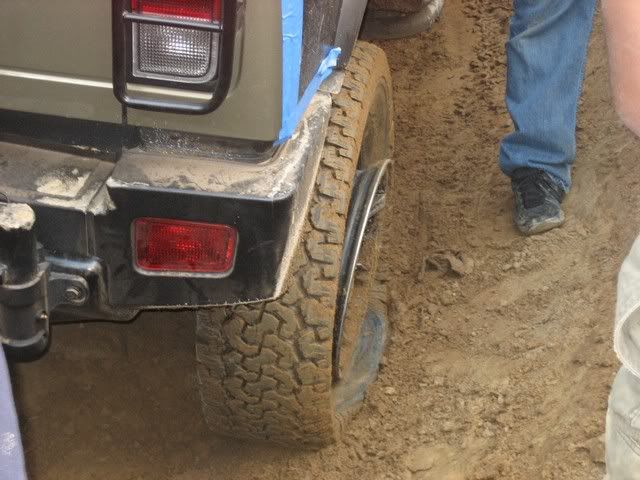

Breaking beads suck!

Another reason to wheel with Adam...
Screwed up valve stems suck too don't they
