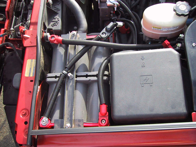

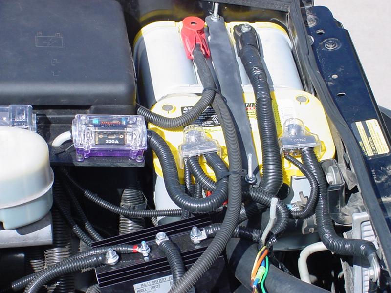

Okay, remote location is one of the 3, and your concerns are valid, unless you mount it inside the cabin (e.g. undr the rear seat (which presents other problems). Following the thousand word principle, I will see what photos I have. BRB.
Old 05-26-2005, 02:01 PM
tower's Avatar
tower tower is offline
Location: Westwwod, CA.
Posts: 2,501
One upright, one sideways. Shot from passenger side.
Old 05-26-2005, 02:07 PM
tower's Avatar
Posts: 2,501
2 loaded sideways, bottom to bottom. Shot from driver's side. (Red tops have same dimensions as yello tops.)

Where did those pics come from. I have tried to get with some tray makers to have that exact setup for mine. I want to add a red top to my yellow top for the cranking amps. The yellows are not enough by themselves if they are a little drained and it gets cold. They don't have the suggested cranking amps that the H2 calls for, so I was wanting to do the Red/Yellow setup with isolation and it looked like it would fit like those pics but I was going to try to fab a tray myself.
So, the question is where?
