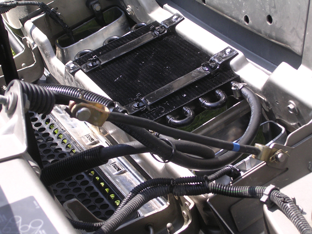

As Phil, change the stock trans cooler with a
Hayden 405 and add on the front an Hayden 404..
On Highway at 80-90 mpg for about 130 miles (without stop) no over 150 °F

Originally posted by PhilD:
BTW I removged the rubber tube from around the hood support cables. I've heard of several of them failing due to rust, from the rubber tube storing moisture.
Mine rubber tubing would never cause this problem. They're baked to the point they look like a severely cracked up dry lake bed. They practically crumbled to dust as I checked them just now. Too much time by the radiator I guess.

That's what mine did when the cable broke...crumbled into a white powder...the new replacements did not have the rubber tube on them.
