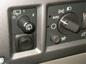

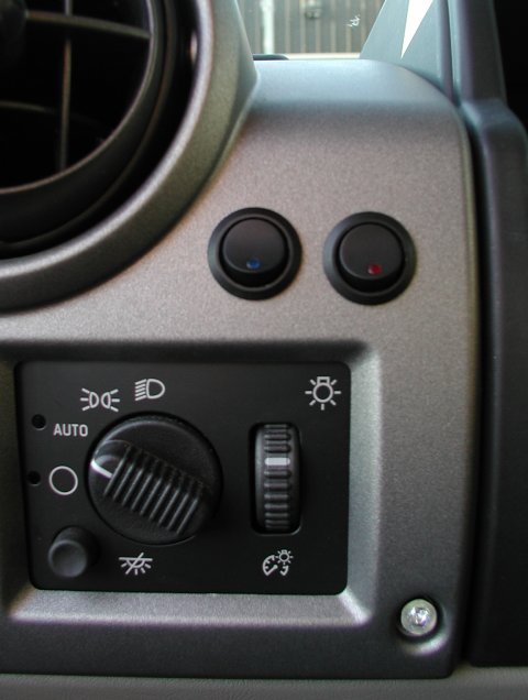

Here is the switch pix. As PhilD mentioned, it looks pretty OEM and has a light when it is on.

I used the same switch, same place and had to trim the rear of the factory switch housing.

Switch mounting- Like others on the forum, I removed my rear wiper switch. You have to take the little bugger completely apart. Be careful not to disturb the wiper switch itself. It is way loose when you remove the front panel and has contacts, PCB, etc. I used a 7/8" wood bit to cut a hole in the plastic front. After a little filing, the switch fit perfectly. If you make sure the top square portion of the switch is just a hair below or even with the ridge channel between the wiper label and the lower blank area (see my picture), the switch will line up perfectly in the opening and allow your dash opening to clear the bottom of the switch. The switch was meant for this spot. Tip; As Buddy mentioned, you have to remove portions of the plastic body of the wiper switch housing in order to get that switch and three lugs to fit back together. I cut the plastic with snips until the cover and switch fit with wires. Not too much cutting but it doesn't fit without some trimming.

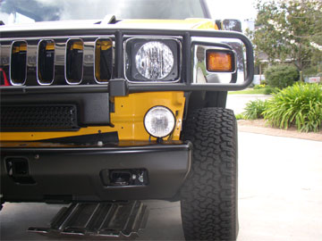

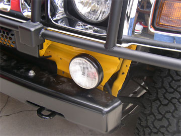

After some heavy pondering, I chose to alter the DRL pockets and mount the lights solid to the metal bumper. I was concerned of shaking in that flimsy plastic bumper.
Although I cut the DRL pockets out first, here is a picture of the lights mounted to the bumper.
[This message was edited by H2Norcal on 04-06-03 at 10:24 PM.]

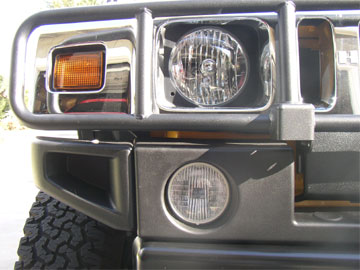

Here is another shot of them mounted.

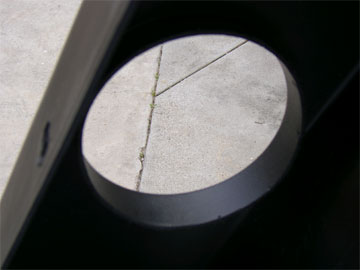

On the plastic, I removed the back mounting portion of the pockets only and made sure I kept the same contour (the pockets are angled to keep the direction facing properly). Basically I cut of about 1 1/2" of the entire back.
Not a great picture, sorry.

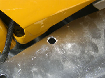

With the backs off of the holes now, you can set the plastic back in place and mark you holes to drill in the bumper (thus the reason you need to remove the metal bumper).
Are you lost? Are you saying to yourself, this guy is nuts, it ain't worth it....if not read on..

Here are the holes in the bumper. Yeah, yeah, yeah, I know, I need a new drill bit.
I cleaned it up.

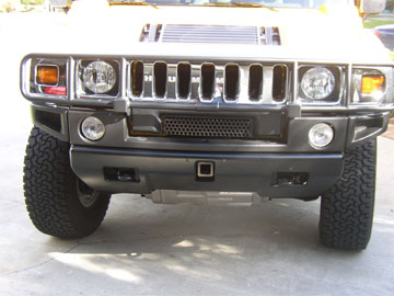

After the holes were in, I mounted the lights. The nice thing about having them mounted to the bumper is they are fully adjustable from each side of the wheel wells and are firmly mounted and don't vibrate.
By leaving half of the original recessed plastic and just removing some of the back, it looks totally factory. Here is the finished product.
Let me know if you really think you want to do this and I can give you more info.
As for the lights, they are very bright. In fact, they are so bright when I turned off my headlights to test them they lit up the road enough to drive. They definitely fill the void where the factory lights skip just out in front of you.

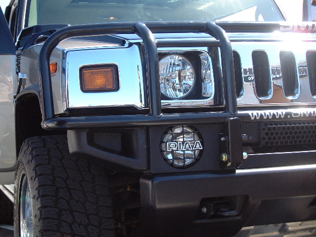

I was at a Hummer event hosted by Hummer of Sacramento and SMA was there with their H2. They had the PIA 520 installed at the DRL location. They said they are going to offer this as a kit for sale. Should be available in May.
