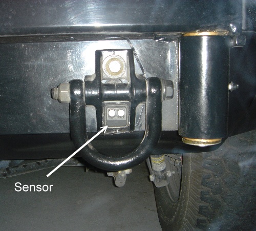

I considered installing a backup camera but frankly couldn't see myself starting the engine, go in reverse & then wait for the image and view it before backing up. So I installed an audio system that announces 8' - 5' - 3' - 2' - 1' & CRASH if it sees anything behind you. Nice for parking too. I first had them mounted (tape) on the bumper and then when I installed my tire carrier ended up installing them in the tow hooks. No drilling. Here's a pic of the sensor. Under $100 bucks and about an hour install.

Has its own speaker mounted right below the rear H2 speaker and yes, hear it fine. And it's not just beeps, it actually "talks" to you in English. Don't know if you can get a Yitish version. When you're about to hit something it sounds like a submarine crash diving. Definitly gets your attention. Pretty cool

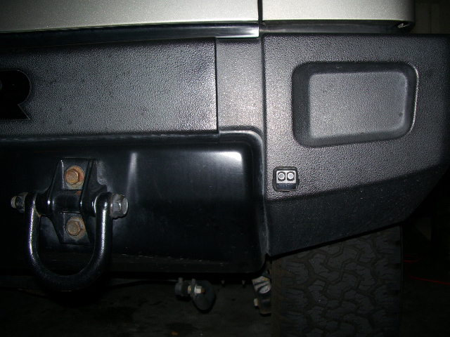

Just got my truck back from the dealer and installed this unit already. Attached are pics from the installation. Maybe this might give you another idea.

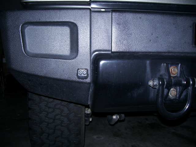

rear passenger side

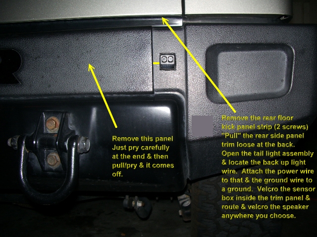

This is a great setup and I was able to get one of the units from JohnnyT (Thanks John!!). Anyway, can you provide additional details on where you placed the 'box' and routing of wires etc. Im anxious to install this but figured it would be good to gain input from a true experienced installer. Thanks in advance </div></BLOCKQUOTE>Here's a doctored pic of where I installed mine before tire carrier. I didn't want to drill so I ran behind center panel, then up & behind rear side trim. I mounted the speaker at the front of the side trim. If you need more info let me know.
