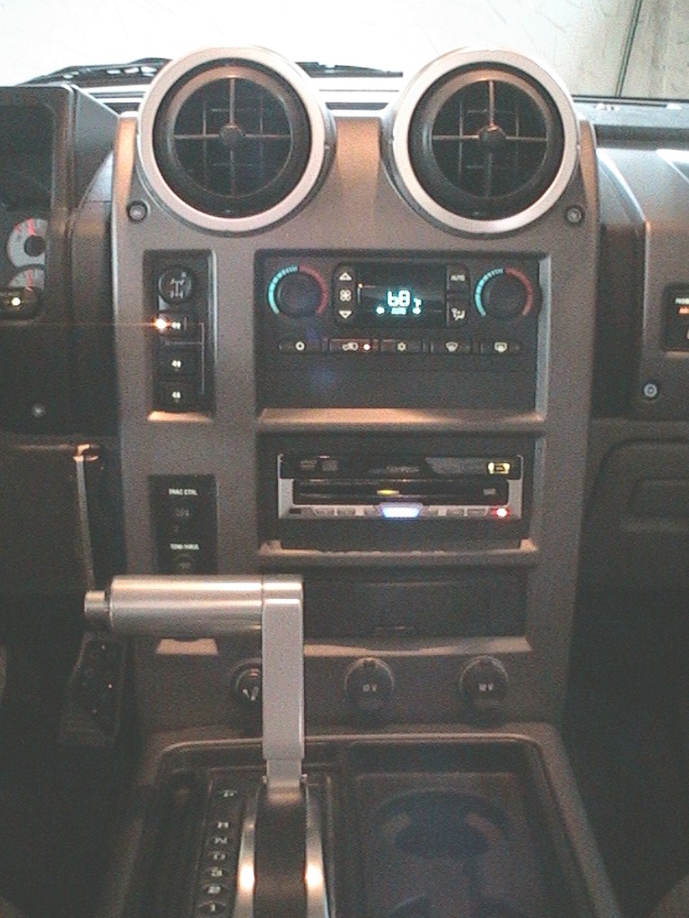

Here's an idea for you to consider: just installed Kenwood head unit with flip out monitor and had my installer relocate the A/C control unit to the original radio 1.5 DIN slot. This allowed me to install the new head unit into the old A/C location and have the monitor open and only conceal part of the A/C controls rather than the vents. I also had them relocate the on-star controls to the small pocket inside glove compartment and put a center channel in that DIN. I am very happy with configuration and everything works perfect. Installer has already taken orders for two more H2 installs based on showing the owner's the setup.

I initially was going to install the center channel speaker above or below the headunit in the remaining 1/2 DIN as well. Keep in mind that if you put it above the head unit it will be covered when the monitor is up and if you put it below it pushes the monitor that much higher which results in completely covering the newly located A/C controls and potentially up into the vents again. End of the day I decided to relo the on-star (still very accessible from driver position) and use that DIN for center speaker.
Total cost for installation labor was about $2K but it included the following and took 8 days to complete:
relo A/C and On-Star (as described earlier)
Installation of Kenwood KVT911, Kenwood center speaker, replaced all factory speakers with Focal component 165 K2 (left the very back stock speakers connected to On-Star), custom box for 10" JL Audio sub in front of spare tire and behind R rear seat, custom mount for JL Audio 500/5 amp/Kenwood DV3100 Nav unit/Kenwood 10-disc changer (above L rear wheel well), (2) headrest mounted Knwd LZ 800 monitors, Knwd 901 dts/5.1 decoder, Knwd Sirius satellite radio unit, hardwire w/remote switch for Passport 8500, Prestige LCD remote-start alarm system, DynaMat entire car front to rear and all doors.
All-in-all, I don't think the relo of the A/C and On-Star was a big deal and the upcharge over just sticking the new head unit into the old head unit location couldn't have been more than $100 (required a custom bracket for A/C unit), but it wasn't broken down that way on the bid.
I will try and get her cleaned up and take a couple pics to post this weekend.

I took these pics with car parked in shade (apparently pretty stupid). I think you can get the idea though.
