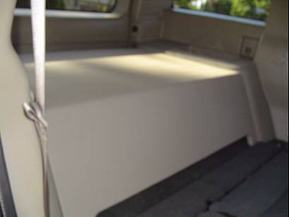

The stealthbox looks like this:
And installed...

I just got a stealthbox installed along with a 500 watt JL amp and remote bass control. The stealthbox is amazing. I'll post pics tonight.

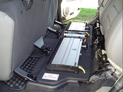

Thanks Guys, What I'm really looking for is how to interface a new amp, where people have located them and how the added power was allocated? ie? was the new amp just to drive a Sub? or did the new amp go to run the existing speakers and the bose amp go to the sub? What aftermarket speakers have you guys had experience with I am thinking about installing Focal Utopia's, does anyone have first hand knowledge of them? Amp Mounting options? I'm concerned about the rear under seat location with regard to being able to fold the seats, My Changer leaves marks on the seat cushions and i dont want to thinks about what a Hot Amp might do.....

Nice! Awesome set up, Do you have any trouble folding the back seats flat?
Old 06-04-2005, 12:56 AM
I have also been concerned with the seat folding down on a hot amp. No burn problems from the heat sinks on the amps against the seats? I assume the imprints go away relatively quickly?

I had this babies under my rear seat for last two years with no heat problems.

Dallion is correct; JL has the best options and the best sounding speakers around. The H2 that the JL web site features is my H2. I just happen to know some of the folks at JL and my H2 was used as the prototype for the stealthbox. It sounds great and does not take up any needed space. Good luck with what ever you decide.

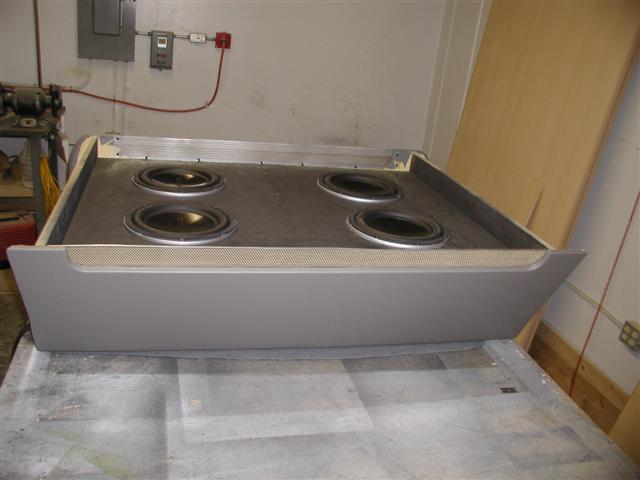

Heres mine with no heat problems.
05 SUT Lux

Beautiful Install! Can you lay down the Seat Backs?

Yes they do, with no worries of damaging the leather.

Wow! Snake II are your sub's located under there? How can you possibly see where you're going? (George Carlin: "Ever notice how you have to turn down the radio so you can see better?")
Nice setup. We're installing a JL audio sealth box and amp in our Excursion. Maybe we'll have to do the H2 as well......the kids will be bouncin'!

LOL! Yes. 4 JL Audio 12w6's.
