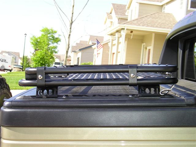

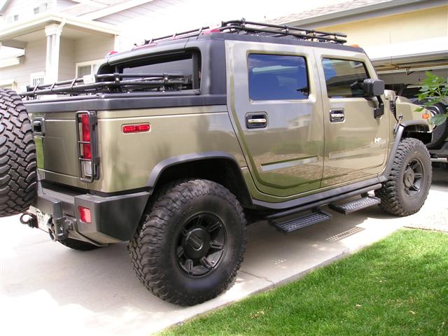

Old 01-25-2006, 01:07 PM
Rod is dead on! It mounts to the cover. When GOBI built these, we mounted it on my bed cover and out three people up there, jumped up and down, took the rack back off and not a dent. So it's built and secured just as tough as their roof racks.
You do have to drill four holes and get spacers to go in there to guide th bolts. It comes with new gas shocks so you can still lift the cover and it will stay in the UP position.
Th eother option is to order it to it mounts to the bed rails. It uses a modified bracket an T Nuts to hold it into the factory track.
This rack does not interfere with the operation of the factory cover or midgate.

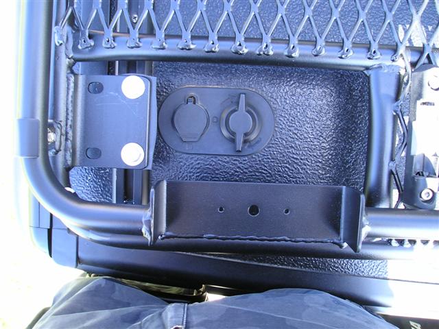

Old 01-25-2006, 01:09 PM
lock opening for factory cover

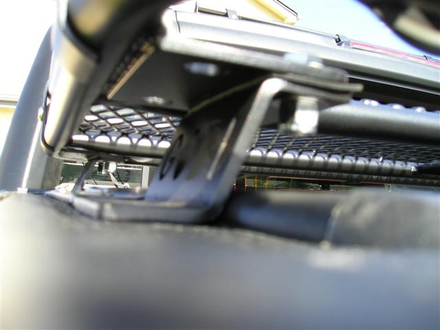

mount. Th other rail you see is not included. That was from when I had some Yakima bike rack stuff mounted on there.
