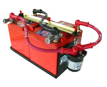

Old 09-11-2005, 03:53 PM
I've got this. It's the best.
http://www.wranglernw.com/commerce/I...emNo=100%2D605
Old 09-11-2005, 04:05 PM
shipbldr shipbldr is offline
Posts: 830
shipbldr is off the scale
http://www.wranglernw.com/commerce/I...emNo=100%2D605 </div></BLOCKQUOTE>
DRTYFN has exactly the same part that I'm describing in my post... Thanks for the pic!
