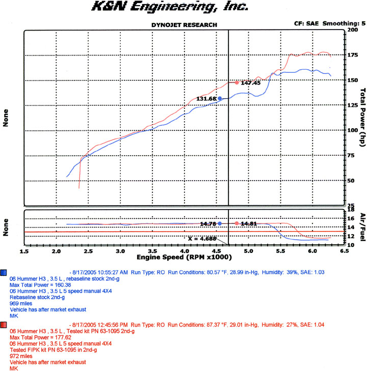

Dynochart for K&N Intake Kit:
2nd Gear Testing on 5 speed manual
Tested with Magnaflow Cat Back Exhaust
Power measured at wheels

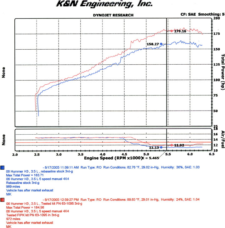

3nd Gear Testing on 5 speed manual

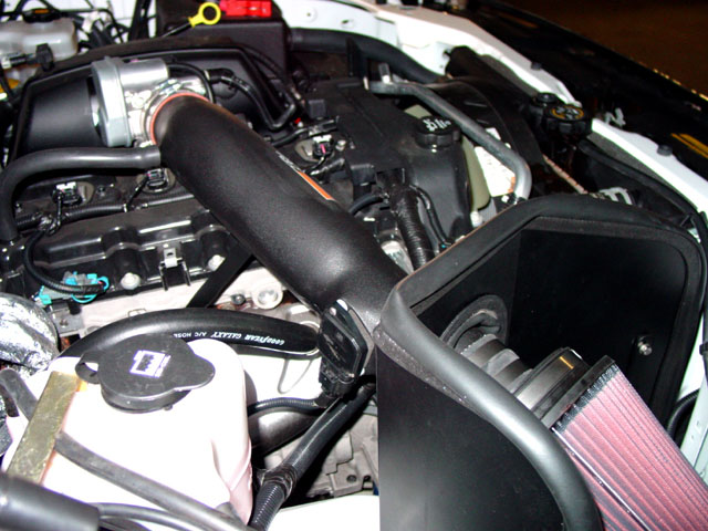

K&N Intake Photo 1 of 3

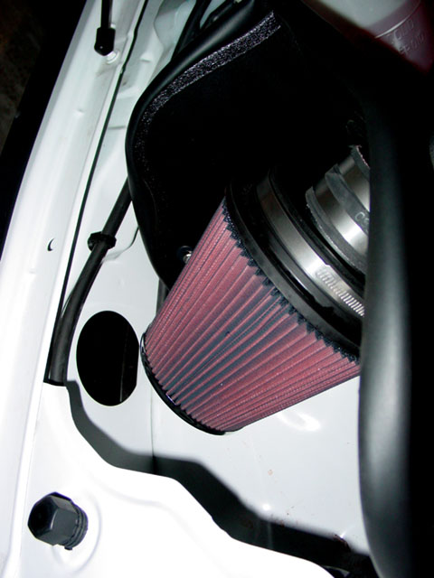

K&N Intake Photo 3 of 3
