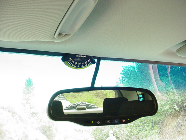

I am guessing the mounting behind the review mirror is a good place so that it reads 0? on level ground.

The gage that Neo shows appears to be stuck on the windshield at an angle which induces an error.

Originally Posted by thedieter
It would be 1/3 = .33 or 33%
You could think of it in terms of the width of the H3, about 6 ft.:
2 ft. higher on one side gives 2/6 = .33 or 33% Hope there are no bumps.
Best regards, Happy Jack
Hey All,
I just got the same gage as Neo. If it is stuck at an angle how much error will it induce? I'm looking for the gauge to tell me if I am getting in the danger zone but I'm not going to be staring at it for an exact measurement. Will the angle make it useless or are we talking a degree or two off, which would be fine. As I said I'm just looking for when I've entered the ballpark of being stupid!
Old 07-10-2006, 09:54 PM
thedieter's Avatar
thedieter thedieter is offline
Location: Yakima, Washington
Posts: 117
thedieter is off the scale
Default Re: Side Slope Measuring Device?
I am going to have to defer to the experienced wheelers since my only experience is from growing up driving on washboard roads.
I have been following this useful Forum to learn what the H3 is capable of.
You could check how much error is induced by putting the gage at different angles and see what the difference is between having the gage face verticle and at an angle at which you are planning to mount it. It looks like the gage has a ball for the indication so it won't suffer from friction.
I don't know when one gets to the stupid point but the door handle dragging may be it. If nothing is dragging, I can't see a problem.
