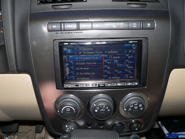

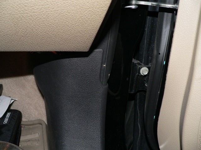

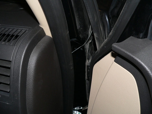

Ok, finally got around the taking pictures.

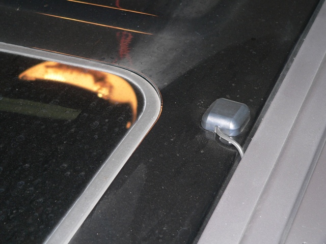

I ran the XM antenna wire down through this kick panel then up behind the weather stripping...
then up through the air intake cap and up through the roof rail channel

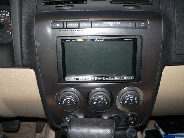

Here is the GPS antenna

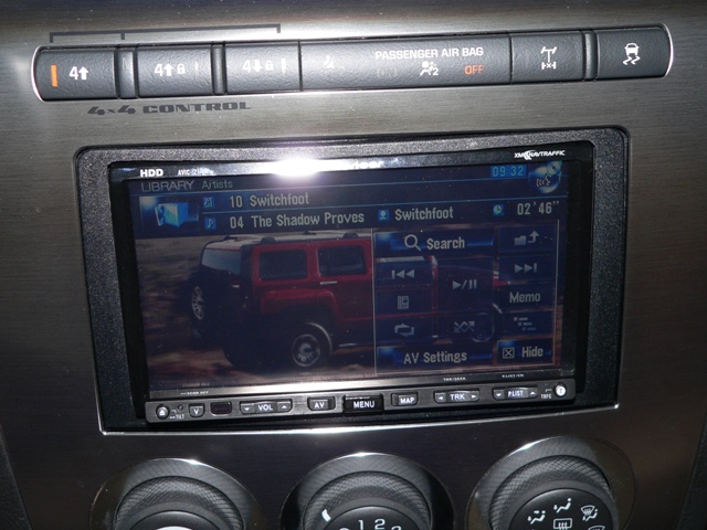

and the XM antenna
2006 H3 Black Luxury package; Off-Road package; Sunroof; AVIC-Z1/Monsoon; XMNavTraffic; iPod adapter; Rear view camera; Front bumper letters; Splash guards; Mudder floor mats; UC Protection

hey the nav looks awsome in there, cant wait to have mine done. Thats how im gona route the cable too. Thanks for the pics!
