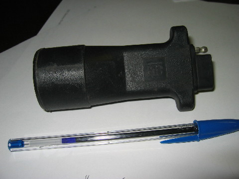

If you get the adaptor and plug it into your H2 and then plug your trailer's lights, they will work fine. The photo shows what the plug looks like.

H2Daddy: Is that a five flat or a 4 flat? (looks like a four flat in the picture) I had a hell of a time finding my convertor for five flat. It seems mostly new heavy boat trailers use them and not very much else. I found mine at West Marine. The plug is the standard flat 4 Wesbar plus a fifth for reverse. The fifth allows the trailer surge brakes not to lock when you got backwards.

My adaptor is a four flat. The four conncetors are left, right, tail and ground. There is no electrical connection to surge brakes. I am not sure what the fifth connection is for.
My trailer manual states that to prevent the brakes from engageing while backing-up, you have to insert a pin into the coupler that prevents the coupler from moving backwards. Surge brakes work by using the weight of the boat (when the truck slows down) to push on the copuler which contains a master cylinder which forces hydraulic fluid to the brake cylinders.

That is what I thought H2Daddy. There is a flat five. Most RV stores have never heard of it. that is why I found mine at a boat store.
