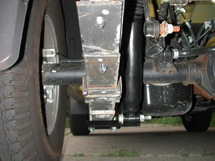

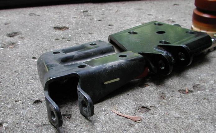

Ground Force makes a shock mount for the H3 that's level with the springs instead of an inch or two below. It's part of a lowering kit, but I bet you could buy it separately. I don't know if you'd need new shocks, but this would really improve the ground clearance.
Here are pics installed and next to the stock mount.

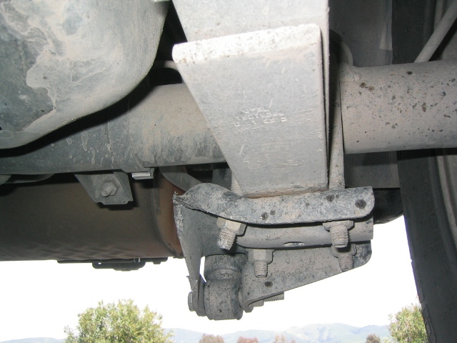

Here's a pic of the stock mount (installed) for comparison.
http://www.groundforce.com/
In working on and looking at the H3 I have often thought it would be nice to have that mount gone or moved up to allow more clearance..I just fired off an email asking about getting these seperate from the (hurts to say it) Lowering kit.

Good find. Wonder if they are as strong as stock.
Hmmm, is that bolt supposed to be bent like that?
I'd be curious to know if these would work, seeing as I need a new mount anyways.

They look good... With the exception of the bolt heads looking very exposed and vulnerable...
Maybe they're not, but from this view they look like hungry rock food.
http://www.elcovaforums.com/forums/a...8&d=1154478679
The stock design still exposes the bolt and is even lower, but yeah that's its biggest weakness.
