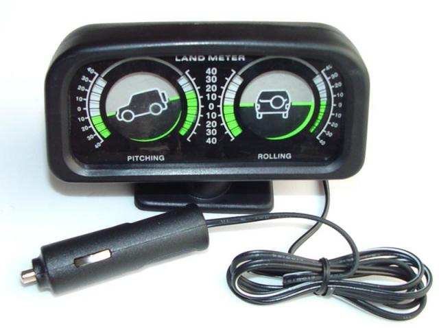

I have one of the cheapo clinometer (land meter) I need a positive wire for the light that will run off the headlights.
Is there any in or around dash compartment,I dont want to run it to the fuse box.
Im planing on removing the swivel base and than velcro it to the top of the mirror (flush to top) than just running the wire along headliner and down the piller to the dash.The wire is thin so it should just stick in without any removal of piller.

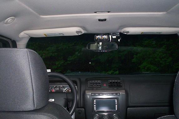

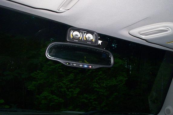

I ended up getting the power from the 2nd gray wire that goes to the rear wipper switch.It works off the light circut that way lights on clinometors on.
I had to remove the swivel base and hack saw off a plastic collor to make the bottom flush.I used thin 3M double sided tape(gray) to mount to the top of the mirror(velcro was not as secure)
Not bad for $12.95
Old 08-16-2006, 12:45 AM
fourfourto's Avatar
Default Re: Need a + wire for clinometer light
Its somewhat level (little off) in the normal mirror viewing position.
On level ground it can be adjusted level if I square off mirror and angle up slightly before off roading.(cant see out the mirror in that position)
Pics are in my driveway (driveway is on a angle up and down to the right, normal viewing position)
View from back seat
