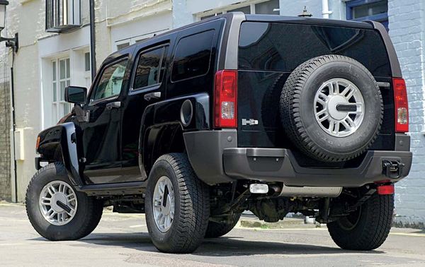

Attached is a photo of an additional mod they do. The left is a backup light and the right is a rear fog light.

Wow as much as I'd like to do that, it sounds like it would still be a while before overseas European operations would be established enough for me to walk-in and order the tail light lens and BCM. Plus, we might not be sure if it is the same form size. (For example, my U.S. Ford Explorer differs a whole lot from the European ones in the read lighting department.)
In my above picture, if you look under the tail light lens assemblies--you see what appears to be a round hole with a cap. Do you know what this is? Is it covering a bolt, or can a wire be snaked through at this location? The reason I ask is that the auxillary backup and fog lamps (currently mounted at the bottom of the bumper) could be replaced with a different set and mounted in this location with the circle.

I'm not sure what is under it, but on the European vehicles, there is a reflector added to this location.
