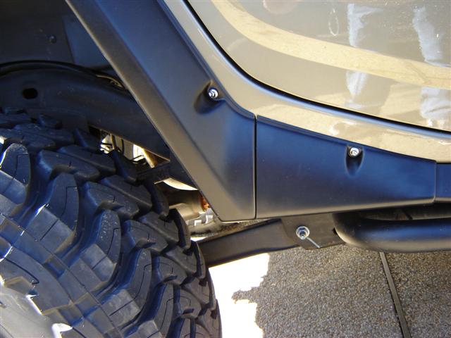

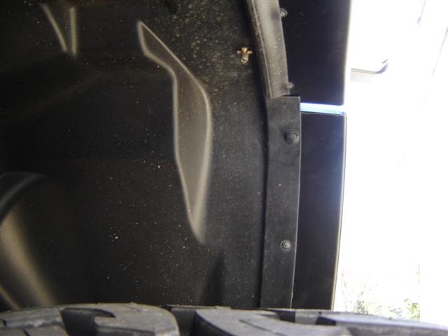

I left a few little things out about the push fasteners, but I broke the ones that came with the kit and saved the ones we removed from the truck. I used SS screws in a few extra places, such as the mud flap area, under the leading edge of the rear flares and the following edge of the front flares. Everything is nice and tight, secure.
This is a small pic of the front driver's side inner well. You can see we used all the stock fasteners and the extra coverage the flares add.

I added a couple of SS screws to the underside of the flares where they meet up with the stock ones in the above pic. I also used a couple in the rear fenderwell to give some additional strength to the mud flaps.

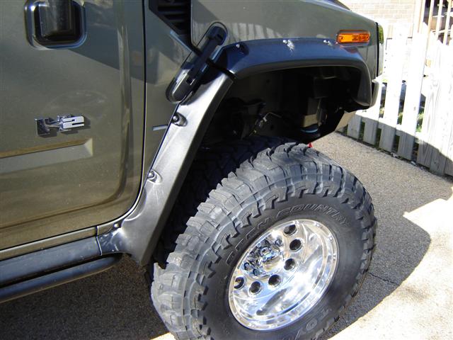

Front.
Any questions?... Other than why I posted the same pic twice?...
I'll run out and grab a pic of whatever you need. Just let me know.

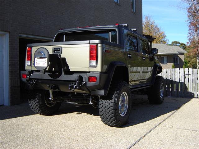

Let's see what we have here.

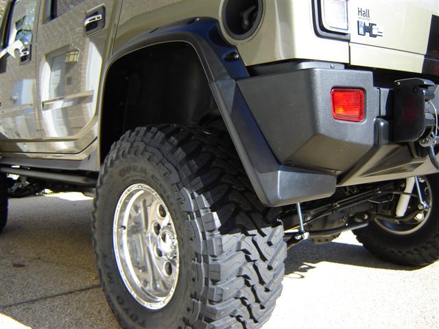

You can see how far the tires stick out in this pic. I think they look about right.

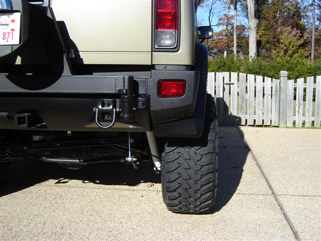

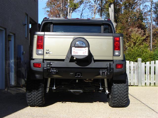

Last one you greedy little monkeys.
